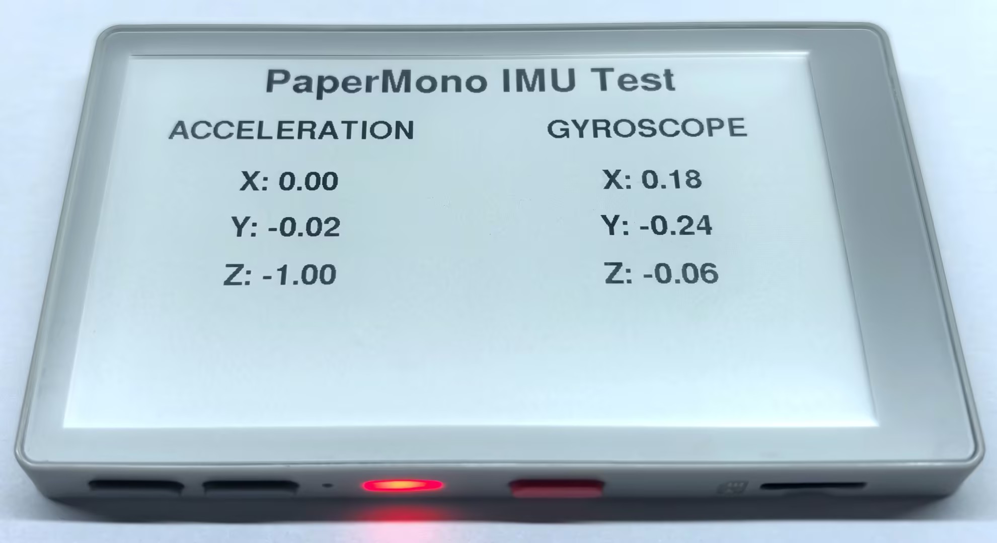

#include <M5Unified.h>
M5Canvas canvas(&M5.Display);
void drawImu(const m5::imu_data_t& data)
    const int w = M5.Display.width();
    const int leftX = w / 4;
    const int rightX = w * 3 / 4;
    canvas.fillSprite(TFT_WHITE);
    canvas.setTextDatum(middle_center);
    canvas.setFont(&fonts::FreeSansBold24pt7b);
    canvas.setTextColor(TFT_BLACK);
    canvas.drawString("PaperMono IMU Test", w / 2, 42);
    canvas.setFont(&fonts::FreeSansBold18pt7b);
    canvas.drawString("ACCELERATION", leftX, 112);
    canvas.drawString("GYROSCOPE", rightX, 112);
    canvas.drawString(String("X: ") + String(data.accel.x, 2), leftX, 182);
    canvas.drawString(String("Y: ") + String(data.accel.y, 2), leftX, 242);
    canvas.drawString(String("Z: ") + String(data.accel.z, 2), leftX, 302);
    canvas.drawString(String("X: ") + String(data.gyro.x, 2), rightX, 182);
    canvas.drawString(String("Y: ") + String(data.gyro.y, 2), rightX, 242);
    canvas.drawString(String("Z: ") + String(data.gyro.z, 2), rightX, 302);
    canvas.pushSprite(0, 0);
void setup()
    auto cfg = M5.config();
    cfg.clear_display = false;
    M5.begin(cfg);
    M5.Display.setRotation(1);
    M5.Display.setEpdMode(epd_mode_t::epd_text);
    canvas.createSprite(M5.Display.width(), M5.Display.height());
void loop()
    M5.update();
    M5.Imu.update();
    const auto data = M5.Imu.getImuData();
    drawImu(data);
    delay(1000);
The program rotates the screen by 90 degrees for landscape display and refreshes it once per second. Accelerometer and gyroscope data are arranged in the left and right columns, respectively.
