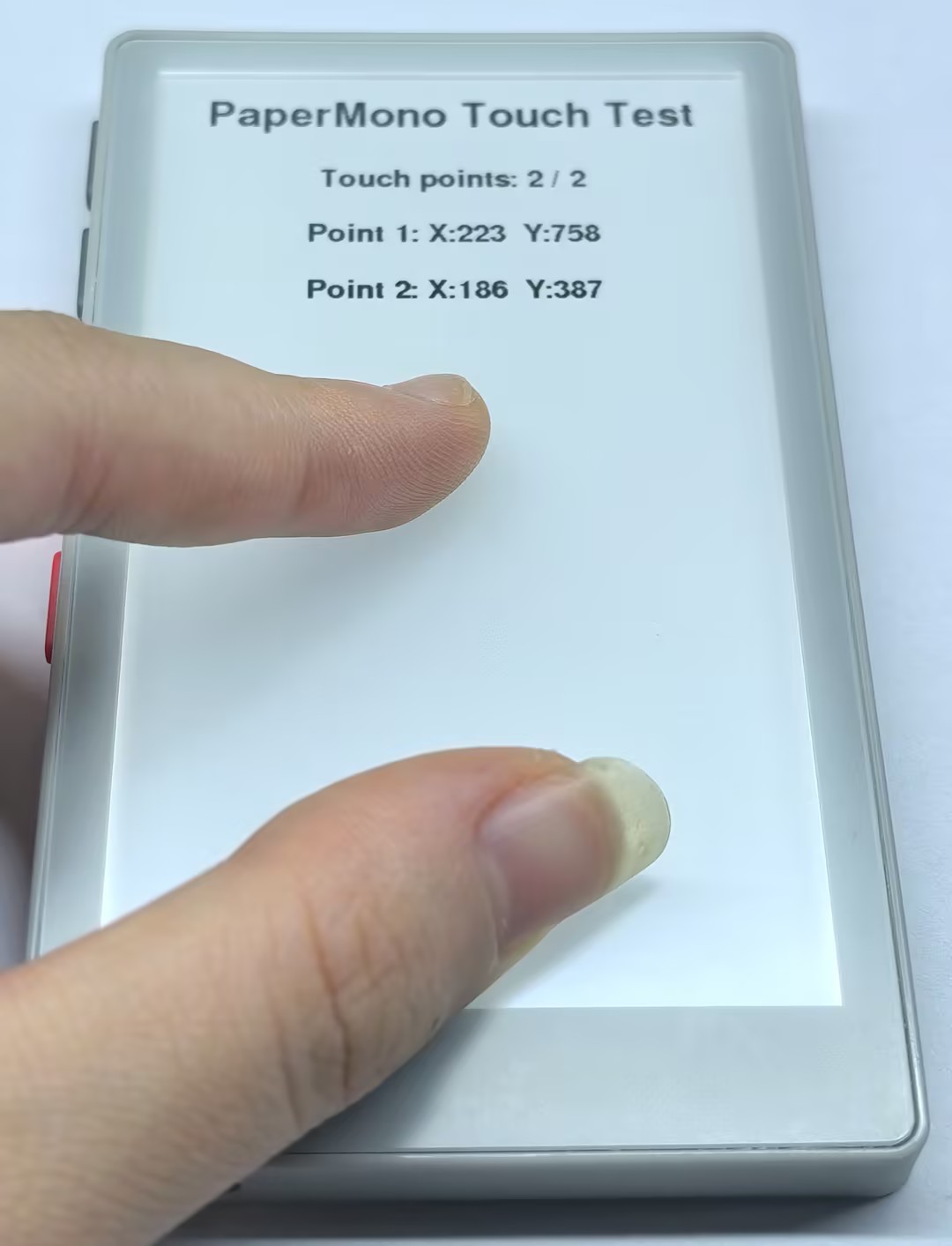

The PaperMono touchscreen displays the number and coordinates of the current touch points and supports up to two touch points. The screen refreshes whenever the touch points change.
