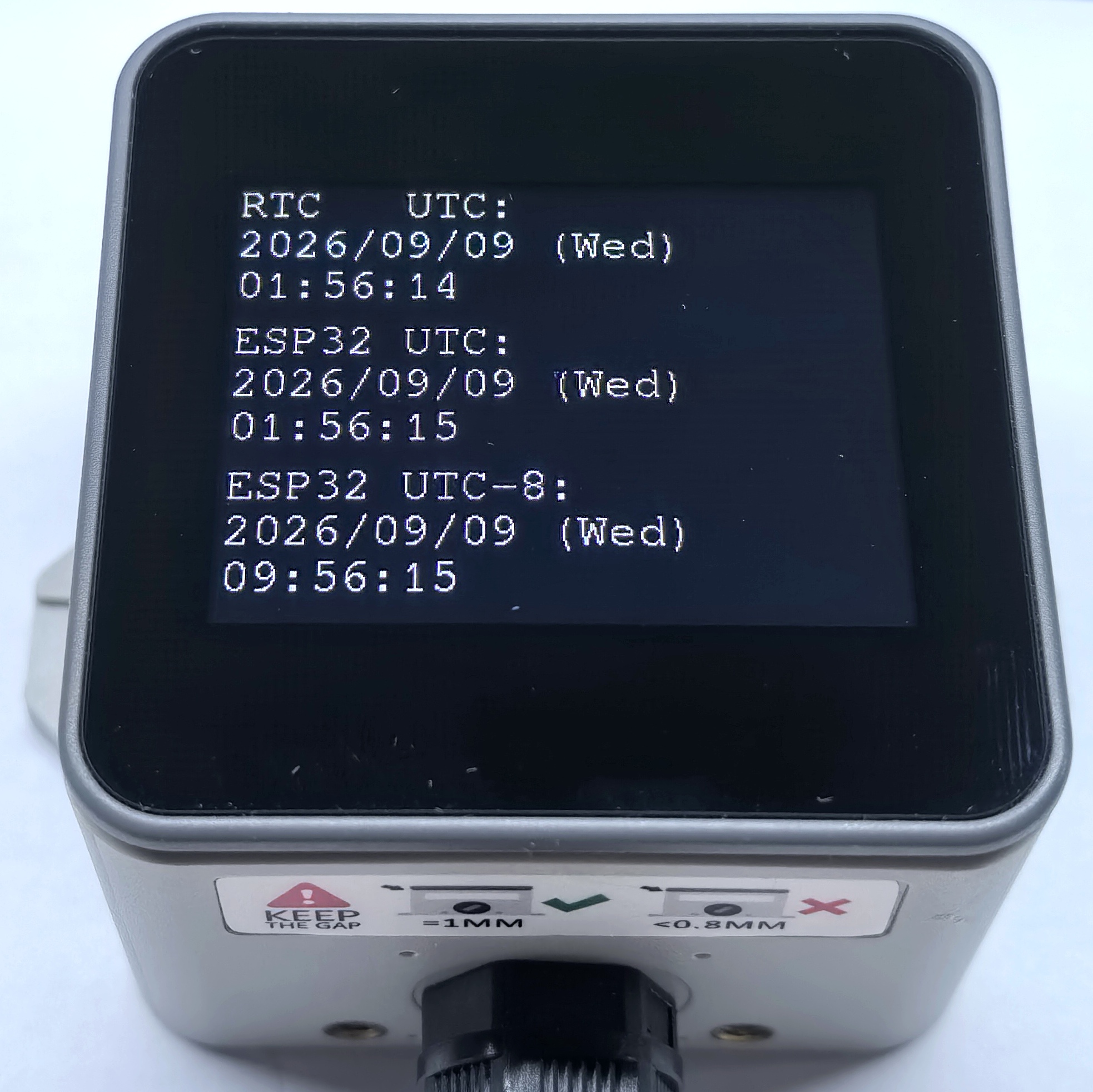

Enter the Wi-Fi name and password and your local time zone in the program, then click Upload to display the real-time clock on the screen.
Note
The NTP_TIMEZONE definition in the program follows the POSIX standard, which uses the opposite sign from common human-readable time zones. For example, "UTC+0" means UTC London, "UTC-8" means UTC+8 Beijing, and "UTC+5" means UTC-5 New York.
