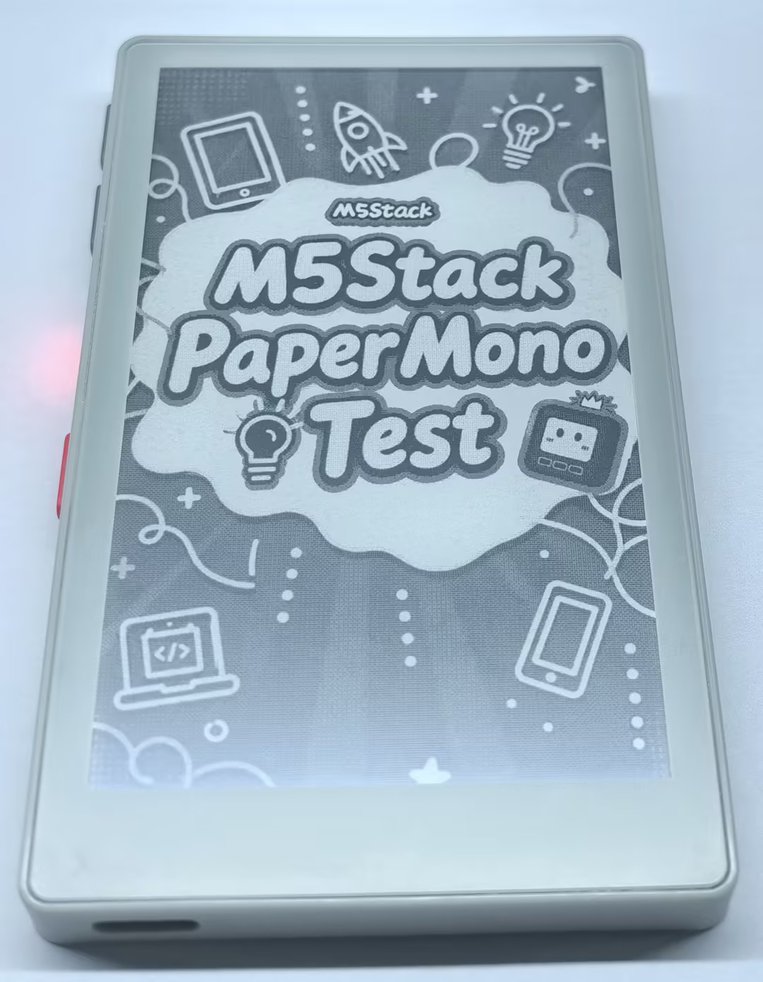

Prepare a microSD card and save the example image PaperMonoTest.jpg to it. Flash the following program to the device and insert the microSD card to refresh the display with the image.
