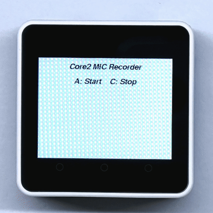

M5.Display.drawCenterString(
"A: Start C: Stop",
displayWidth / 2,
45
void loop() {
M5.update();
if (M5.BtnA.wasClicked() && !isRecording) {
startRecording();
if (M5.BtnC.wasClicked() && isRecording) {
stopRecording();
return;
if (isRecording && wavFile) {
if (!captureOneBlock()) {
stopRecording();
}Insert a FAT32-formatted microSD card into Core2. After the program starts, tap the A touch button at the bottom of the screen to start recording, and tap the C touch button to stop recording. When recording is complete, the file is saved to the root directory of the SD card as recording.wav.
The Core2 microphone uses the Mic_Class in the M5Unified library. See the following documentation for more related APIs:
