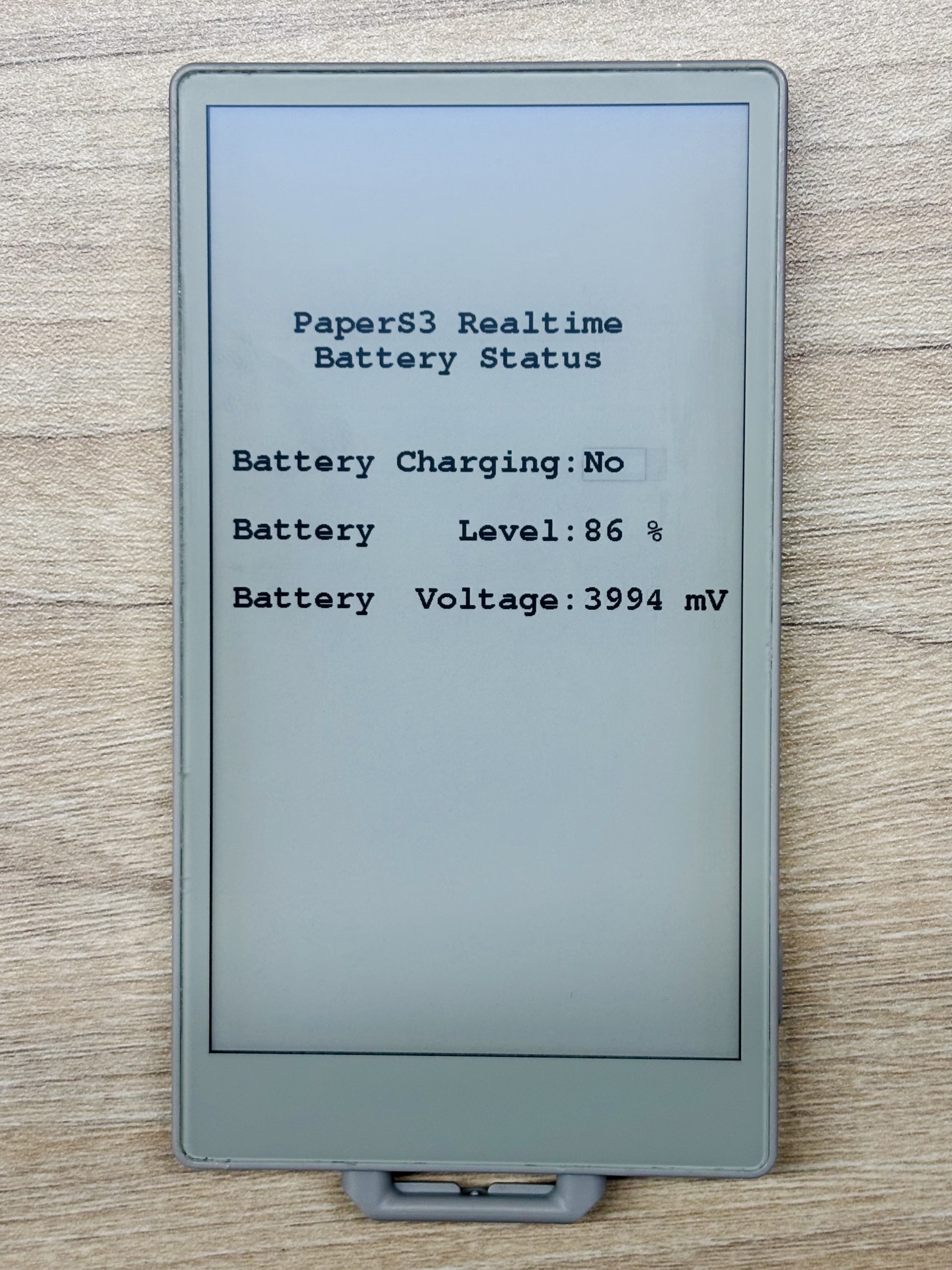

#include <M5Unified.h>
#include <M5GFX.h>
void setup() {
  M5.begin();
  M5.Display.setRotation(0);
  M5.Display.setFont(&fonts::FreeMonoBold18pt7b);
  M5.Display.setCursor(0, 200);
  M5.Display.print("    PaperS3 Realtime\n");
  M5.Display.print("     Battery Status\n\n\n");
  M5.Display.print(" Battery Charging:\n\n");
  M5.Display.print(" Battery    Level:\n\n");
  M5.Display.print(" Battery  Voltage:\n\n");
void loop() {
  M5.update();
  bool    isCharging     = M5.Power.isCharging();
  int32_t batteryLevel   = M5.Power.getBatteryLevel();    // 0 - 100 %
  int16_t batteryVoltage = M5.Power.getBatteryVoltage();  // unit: mV
  M5.Display.setCursor(380, 340);
  M5.Display.printf("%s \n\n", isCharging ? "Yes" : "No");
  M5.Display.setCursor(380, 410);
  M5.Display.printf("%d %%  \n\n", batteryLevel);
  M5.Display.setCursor(380, 480);
  M5.Display.printf("%d mV   \n\n", batteryVoltage);
  delay(2000);
该程序将在屏幕上显示电池是否正在充电、电量百分比、电池电压,每2秒刷新一次。由于硬件限制,PaperS3无法读取电池电流。
